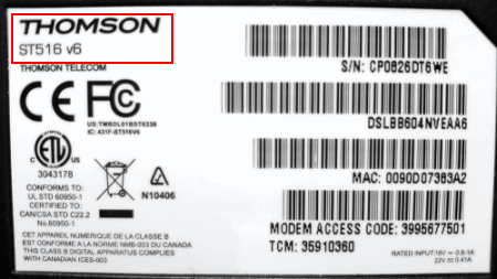

Check the label on the bottom of your router and make sure it says ST516v6 in the top left corner (pictured below). If the label on your router says ST510v6, you need to follow the ST510 Connection guide.
Check the label on the bottom of your router and make sure it says ST516v6 in the top left corner.

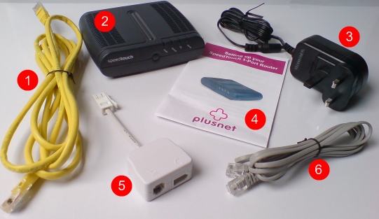

Your package contains:
Hardware Pack Contents.
  1. Ethernet cable
  2. SpeedTouch ST516v6 router
  3. Power supply
  4. Setup guide
  5. Microfilter
  6. Broadband cable
