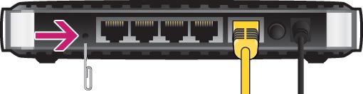

9. How do I 'factory reset' my router?
How to factory reset.
If you have any problems setting up your router, you can reset it and start again.
Use a paperclip, pen or pointed object to press into the reset pin hole on the back of the router. Keep the button pressed in for at least 5 seconds. When the power light goes red, release the button and wait until the power light turns green again.
From this point on, your router will be restored to 'Factory Settings' so you'll need to set it up again. Please see our Netgear WNR1000: setup guide if you need any help.
