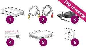

1. What you'll need to get connected
Check that you've got the following items:
  • Your Technicolor 582n router
  • 2 Ethernet cables (1x yellow ends, 1x red ends)
  • Power supply
  • Setup card
  • BT Openreach modem
  • Fibre master socket
The BT Openreach Modem and Fibre master socket are supplied and fitted by the BT engineer who installs your service.
The contents of your router pack.
