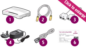

1. What's in the box?
Check that you've got the following items:
  • Your Technicolor 582n router
  • Ethernet cable (yellow ends)
  • Microfilters
  • Power supply (two-part)
  • Internet cable (grey ends)
  • Setup card
  • Setup guide (not shown)
The contents of your router pack.
