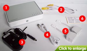

    As well as your Thomson 585 setup guide, you should have:
    Make sure you've got everything
    • Your Thomson 585 router
    • Ethernet cable (yellow ends)
    • Power supply (two-part)
    • Internet cable (grey ends)
    • Microfilters
    • Setup sticker
